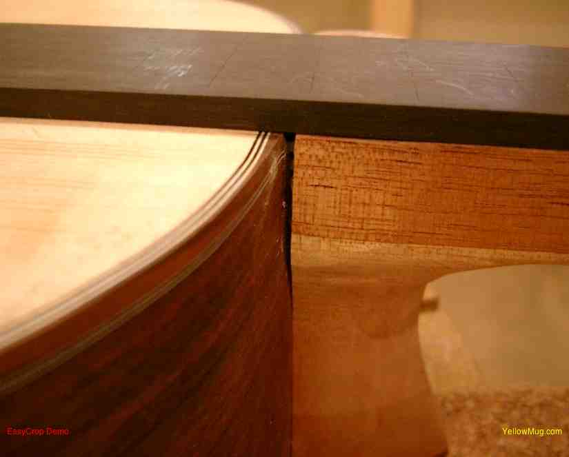

While Tracy's having her nightmares with gaps I thought I'd carry on the
theme.
Im trying to deal with a 2mm gap between side and heel on my classical.
The guitar is being built using spanish method and sides were fitted into
slots cut into heel block and then glued up with wedges glued into slots
behind sides.
The problem came about because of angle of slots being slightly out and
not quite matching matching curve of heel end of sides.
Any ideas on filling the gap would be appreciated. All I can think of is
putting in a spanish cedar wedge or filling the gap with epoxy mixed with
spanish cedar dust.
Cheers Martin
PostPosted: Tue Apr 11, 2006 4:56 pm
Posts: 228
Hi Martin,
You could put a wedge in place but you would have to be aware of the grain direction so that the reflected ligth on the surface doesn't make the wedge stand out. You could also at the same time make sure that the piece you are inserting goes in at an angle so that it overlaps the rest of the neck material. If you do this you reduce the line definiton.
regards
Tim

I have all the offcuts from the heel block area so shoudlnt have any
problem matching up grain direction. The fretboard isn't on yet so I
should be able to work a wedge in from the top.
Cheers and thanks
Martin
PostPosted: Tue Apr 11, 2006 6:13 pm
Martin, what if you fit the wedge so you have a solid block and glue it in place, than cut a shallow channel with a 1/8" chisel and bound the end of the heal. I've never seen it, but it would eliminate the line of the wedge and it may look kind of cool.

[QUOTE=Rod True] Martin, what if you fit the wedge so you have a solid
Oh, and by the way, Tracy is a Guy [/QUOTE]
Well thats two big boos boos in one day then....the canyon like gap on my
guitar and calling Tracy a "her". My apologies to Tracy if hes reading this.
Interesting option of yours in regards to the gap....will have a serious look
at that one. Got some plain solid RW binding that would do the trick.
Thanks Martinkiwigeo38819.1519560185
PostPosted: Tue Apr 11, 2006 11:23 pm
Posts: 8553
Martin, I was thinking the same thing as Rod, I would try to make it look intentional. You could possibly use Ebony and tie it in to your fretboard binding so that the bindings looks as though it runs down the fretboard and wraps around the heel? Also using ebony would make any gaps that are likely to appear easier to hide.

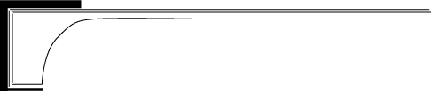

I'm with the binding idea. Done right and purfled well, it will not only "not look bad" but could look great. Splicing in a piece of Cedro will do the trick but will always be visible, even if you match the grain perfectly.
Here's the way I'd tackle it. If you don't have a heal cap on yet, put one on with veneers to match teh side purfling. Then follow those lines up and along the fingerboard. Here's a rough pice to explain. I over emphasized the miters so you could tell what I was talking about.
PostPosted: Wed Apr 12, 2006 3:13 am
I like the binding idea too! Wedging in some neck wood will most likely look like a mistake rather than a planed "upgrade"!

Martin,
Given your current predicament, I think Rod's suggestion is the one that will save the proverbial bacon. A continuation of the binding down along the neck heel will give it an intentional look. What's the old saying? The difference between a pro and an amateur is the pro is better at covering his mistakes? Something like that.
I'm curious, though. Do you build using a mold or an open workboard? I build classicals, and I've had to deal with gaps, some almost as big as yours. To me it is much easier to close gaps with wedges and shims when building using an open workboard as opposed to a mold. A mold confines the sides such that, unless the side slots are cut perfectly, gaps will show, and can't really be closed. An open workboard gives me the flexibility I need in this case. The guitar's upper bout may deviate somewhat from its originally intended shape as a result of this, but I'll wager nobody can tell.

I work on an open workboard. As explained in original post the gap came
about mainly because I didnt cut the side slots at correct angle. Sides
were hand bent as well so getting a sharper bend right at the end of the
side where it fits into the slot was very difficult.
